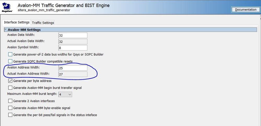

What is Actual Avalon Address width in Traffic Generator ip?
​I have instantiated my DDR3SDRAM on HPS side and I want to connect it to a traffic generator. I found this avalon traffic generator ip but there is this option of actual Avalon address width option. What is this option about? My address bit is 32 bit.
  • Hi matif,
    Thank you for joining this Intel Community.
    When you used SOPC Builder System, you need to enable/tick the " Generate per byte address" option and the driver will auto generate per byte address for you. In short, you will see Actual Avalon Address Width = 34 bits (extra 2 bits) when your avalon address width is 32 bits.
    Hope this clear.
