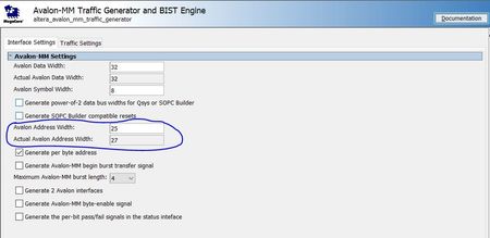

7 years agoWhat is Actual Avalon Address width in Traffic Generator ip?
I have instantiated my DDR3SDRAM on HPS side and I want to connect it to a traffic generator. I found this avalon traffic generator ip but there is this option of actual Avalon address width option....

Hi matif,
Thank you for joining this Intel Community.
When you used SOPC Builder System, you need to enable/tick the " Generate per byte address" option and the driver will auto generate per byte address for you. In short, you will see Actual Avalon Address Width = 34 bits (extra 2 bits) when your avalon address width is 32 bits.
Hope this clear.

7 years agoHi matif,
Hope this clear.
