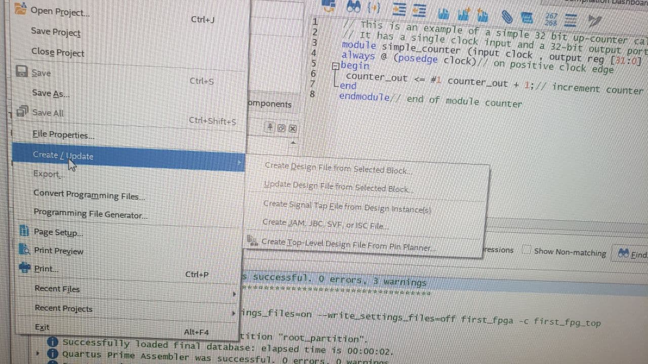

I am working on Quartus prime pro 20.3 and I was going through "my first fpga tutorial". Here it says after creating simple_counter.v verilog code, we need to go to create/update and create block diagram for current file.
My whole create/update file is disabled and I even in disable mode, I dont even have the option to create block diagram for current verilog file

Hi Parisa,
This this option has been removed from the Intel® Quartus® Prime Pro Edition software starting version 18.0 and only available in Standard Edition. The reason is because symbol files are not an industry standard format. Below is KDB related to your issue.
