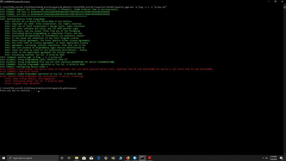

The device chain in Programmer does not match physical device chain.
I am trying to run Open CL on windows for Stratix De 10 pr, while initializing the FPGA with open CL image i get the following error
Error (18952): Error status: The device chain in Programmer does not match physical device chain.
please help me in solving the error

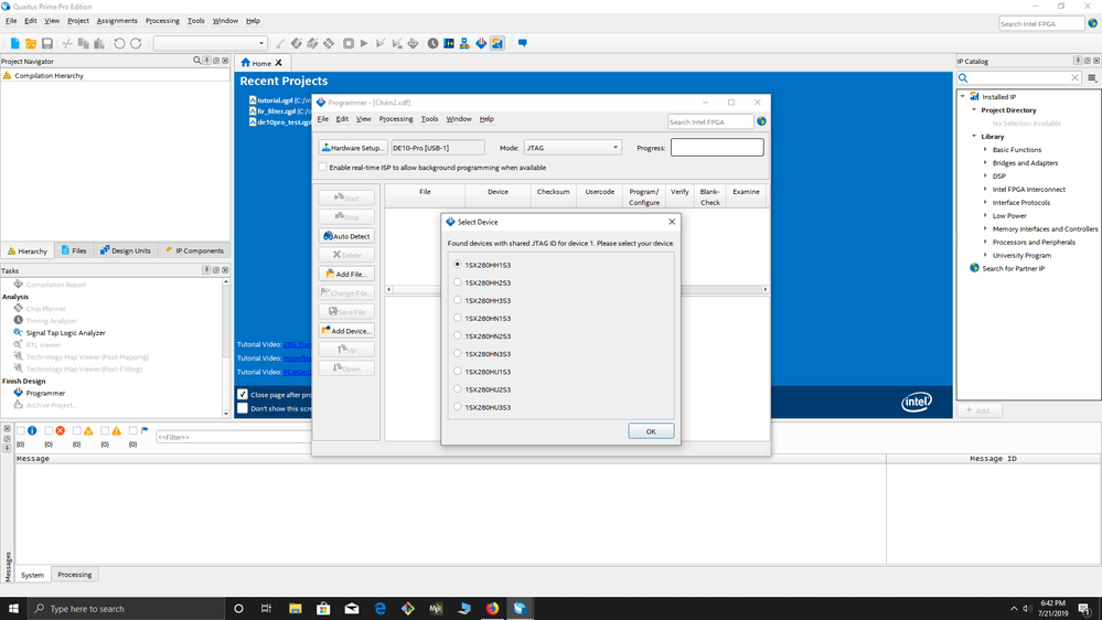

  • JohnT_Altera's avatar
    JohnT_Altera
    You can identify the device you are using by performing Auto-detect using Quartus Programmer tools.
    You will need to use the correct OpenCL BSP for you to generate the correct bitstream.
    May I know which board are you using and where do you download the BSP?
    JohnT_Altera
    The list is showing all the device that is having the same Device ID. As long as you are using the sof file that is in either 1 of the device list then you will not received message saying incorrect JTAG ID detected. From the list, you will observed that the device density is the same except for the last few character which determine the transceiver channel count and the device package.
    JohnT_Altera
    Hi
    I think I make a mistake as your device should be 1SX280H device while the OpenCL BSP that is available from Terasic is for 1SG280H device. Please contact Terasic to see if they have OpenCL for 1SX280H device.
