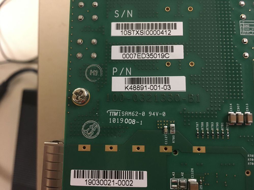

It is the DK-SI-1STX-E-A board, the label on the box says to. It looks like the board from the link, with two "MXP" on the upper right side, contrary to some documentation (the Quick Start Guide) which have three.
We got approval for donation in March 2019 (Donation Request Ticket [BR12170]), but it was not shipped until July 2019, probably to send us the Production Board and not ES.
I have also added a photo of the S/N and P/N of the board, on the backside of the PCB.
