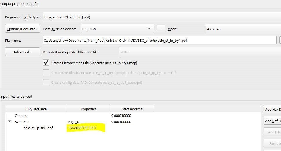

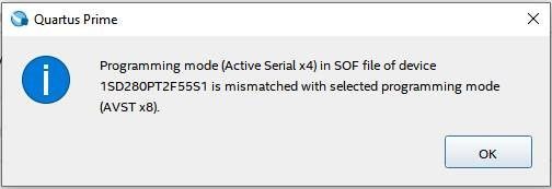

while creating POF file i ran into error; the screenshot is attached.
furthermore i find out that while generating POF file, the GUI displays wrong part number. (screenshot attached)
can you help me move past this error; so i can generate POF file

    Hi Ankit,
    From the error message, seems like you are configurating Active serial configuration mode in quartus design. Can you please change to AVST x8 in Quartus? To do so, go to Assignment -> Device -> Device and pins options -> Configuratio -> Configuration Schema.
    Thank You.
