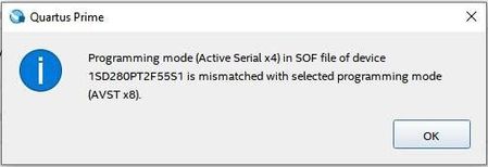

I am using following user guide https://www.intel.com/content/dam/www/programmable/us/en/pdfs/literature/ug/ug-dex-ptile-pcie-avst.pdf I was able to generate SOF file without any issue. I have s10...

From the error message, seems like you are configurating Active serial configuration mode in quartus design. Can you please change to AVST x8 in Quartus? To do so, go to Assignment -> Device -> Device and pins options -> Configuratio -> Configuration Schema.
