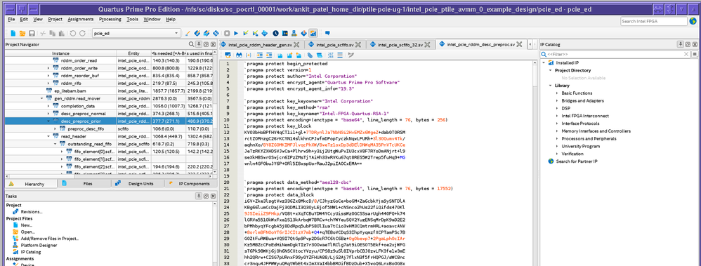

While generating PCIe IP through IP catalog , there was no option to define extended config space or DVSEC registers. so in order to do what i want, I started reviewing RTL files; generated by PCIe IP compilation in Quartus. Many of the files appears to be encrypted (see the screenshot); and I can not read the RTL code associated with these modules. Do you know how to decrypt these RTL files? So I can read them and identify lines of code, which needs to be modified.
- BoonT_Intel
Hi Sir,
I am sorry. If the code is encrypted. This mean it is intended to make it no accessible by user. And it is also encrypted on my side.
