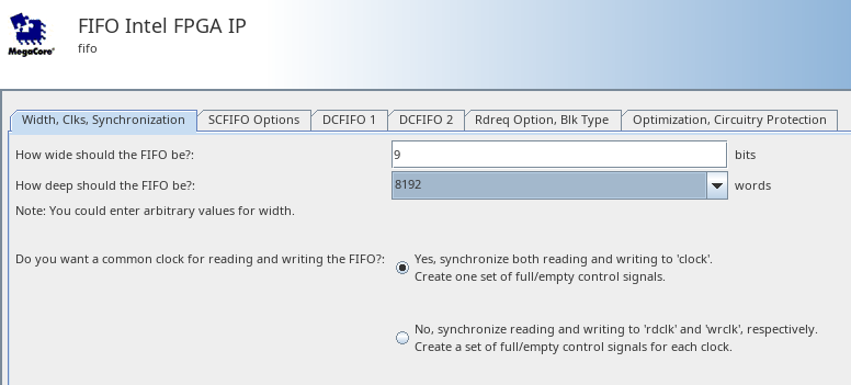

For FIFO IP, you may use FIFO Intel FPGA IP check screenshot:
For the suitable device, will get you answer later.
