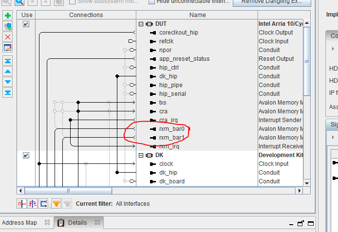

I have looked at some examples for Qsys projects using the PCIe Hard IP block and I understand how the rxm_bar<n> Avalon interfaces are used to access memory mapped regions through PCIe:

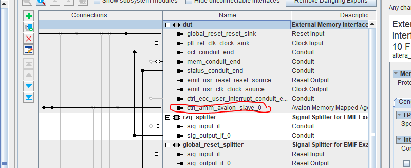

I also saw an example of the "External Memory Interface IP" to see how to communicate to DDR and I see the Avalon Slave on the EMIF is used to read/write to DDR:
However, I cannot connect the rxm_bar<n> interface directly to this because the EMIF provides its own clock for the transactions to the EMIF.
