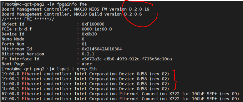

N3000-2 XL710 or XVV710?
Q1: Why is it that when I execute 'lspci' command on my server, the result is XXV710, but the corresponding device in the N3000 manual is XL710?
Q2: Will XL710-BM2 or XXV710 in N3000-2 support RDMA?
Thanks for your reply!
13 Replies
- JonWay_altera
1) Thanks for the feedback. I have filed to confirm and correct on this issue.
2) Based on below spec:
Both XL710 and XXV710 does not support RDMA
- JonWay_altera
In the newest PV1.1, in lspci, there is no mention of the variant to avoid confusion.
The datasheet naming remains XL710.If you still seeing this issue despite having the latest Acceleration Stack + drivers installed.
Can you share with me the i40e and NVM firmware driver versions? Run "ethtool -i <linkname>"For linkname, you can get by running "lshw -c network -businfo"...look at the corresponding linkname to the BDF of the Ethernet controller.
