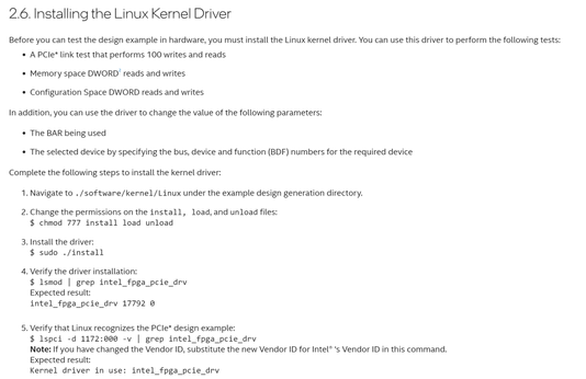

When I follow https://www.intel.com/content/www/us/en/docs/programmable/683527/21-1/generating-the-design-example.html Chapter 2.6. Installing the Linux Kerbel Driver to install driver for S10 dev kit card and want to verify the driver is installed correctly.
So I run the command,
$ lsmod | grep intel_fpga_pcie_drv
then the output is,
intel_fpga_pcie_drv 32768 0
Next command is $ lspci -d 1172:000 -v | grep intel_fpga_pcie_drv, while there is no output. I'm not sure if the vendor and device id in the guide is suitable for this card, so I just run
$ lspci | grep intel_fpga_pcie_drv
and also no output.

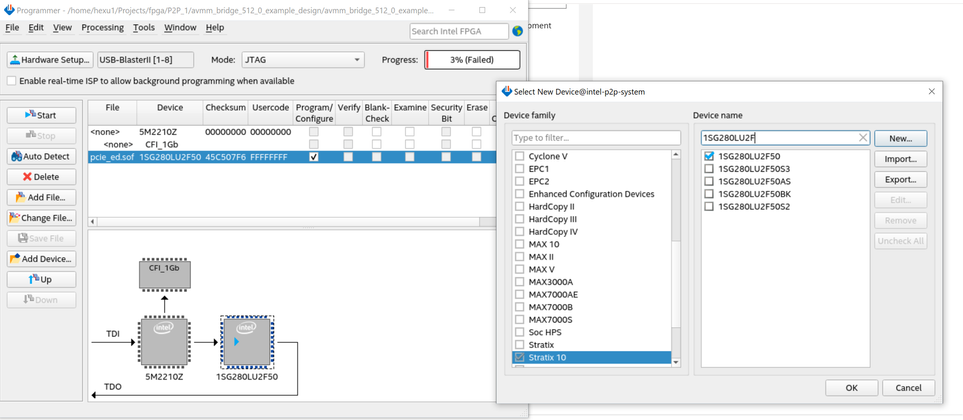

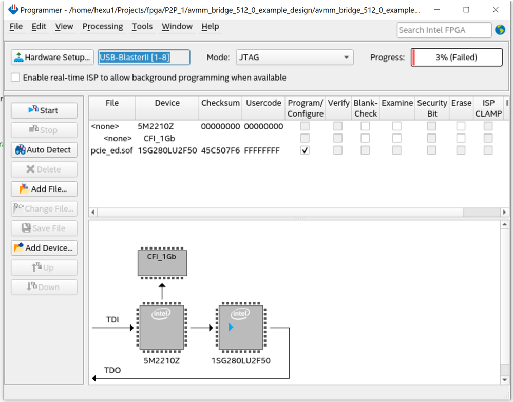

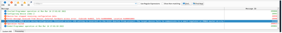

    I found that programming the FPGA has just failed. Maybe that's why the PCIe cannot detect the card.

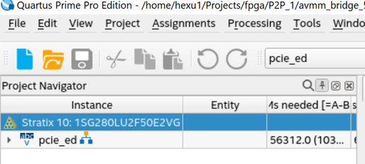

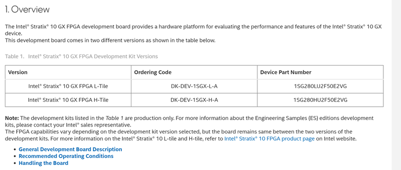

    I have checked the device id. The ordering code of s10 dev kit card is DK-DEV-1SGX-L-A.
    So I chose the device in Quartus Software like this.
    While in Programmer box, there is no 1SG280LU2F50E2VG, so I chose 1SG280LU2F50.
    Is it caused by wrong selection for device ID that I cannot program the sof file to the card successfully? Or any other insights about the reason?
    Look forward to reply. Thanks.

      This issue is solved after adding necessary QSF setting to the configuration. While the card still could not be detected via PCIe.

    In Step 5 when you executed lspic to verify if Linux recognizes the PCIe design example but no output, this indicate that the S10 dev kit was not detected by the host. 0x1172 is the S10 PCIe Vendor ID. The PCIe IP for all FPGA families are using this similar Vendor ID.
