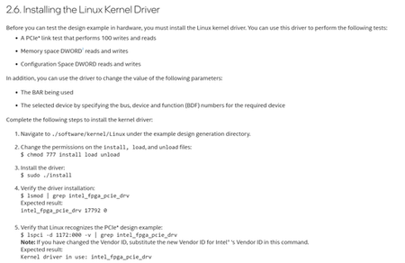

4 years agoMeet issue when enabling Avalon memory mapped IP on S10 GX dev kit card
When I follow https://www.intel.com/content/www/us/en/docs/programmable/683527/21-1/generating-the-design-example.html Chapter 2.6. Installing the Linux Kerbel Driver to install driver for S10 dev k...
- 4 years ago
Thank you so much for reply.
I just solved this issue by choosing the correct target dev kit when compiling the IP design. This issue is caused by the wrong pin mapping.
skbeh
Contributor
4 years agoIn Step 5 when you executed lspic to verify if Linux recognizes the PCIe design example but no output, this indicate that the S10 dev kit was not detected by the host. 0x1172 is the S10 PCIe Vendor ID. The PCIe IP for all FPGA families are using this similar Vendor ID.
$ lspci -d 1172:000 -v | grep intel_fpga_pcie_drv
He4Forum
4 years agoThank you so much for reply.
