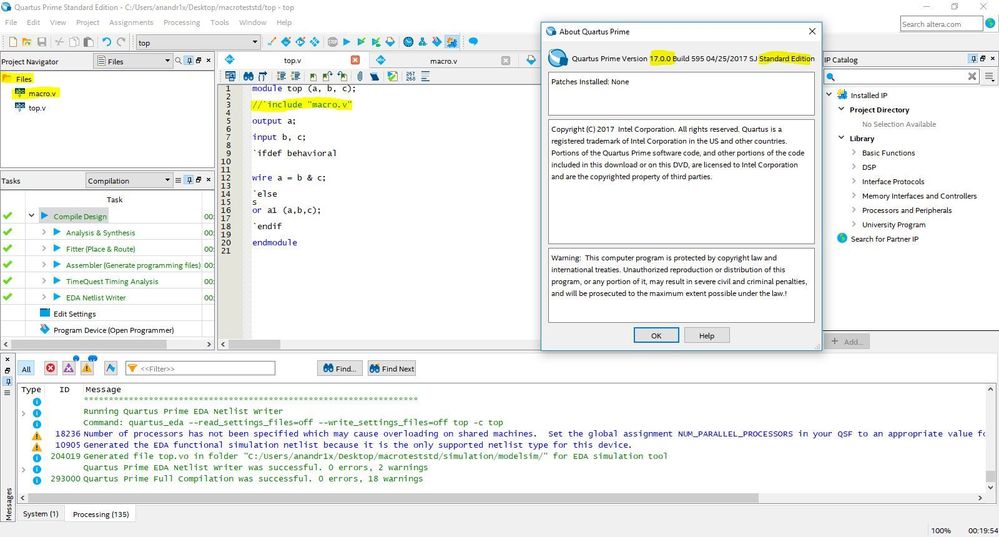

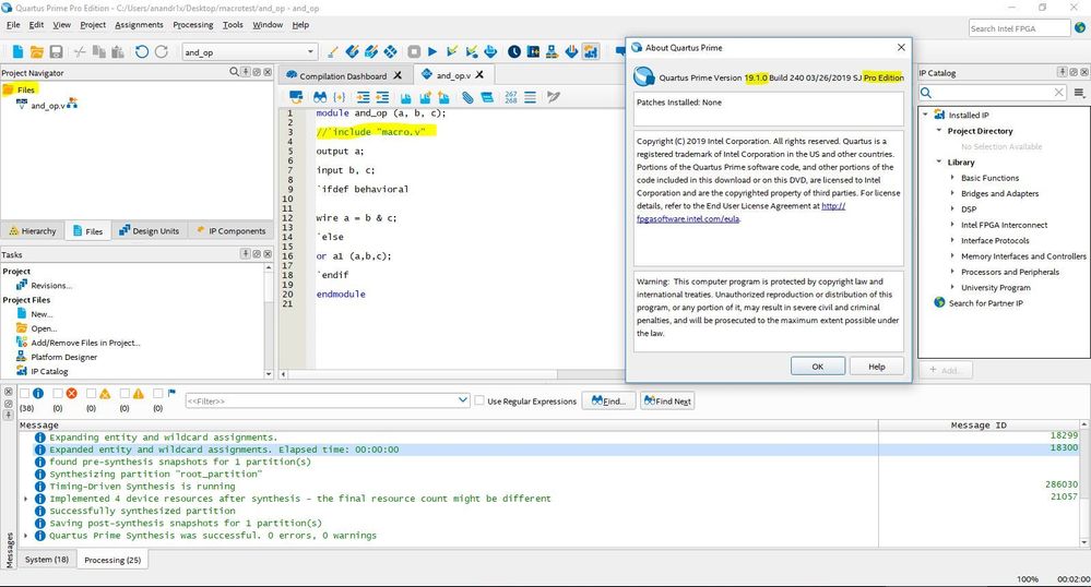

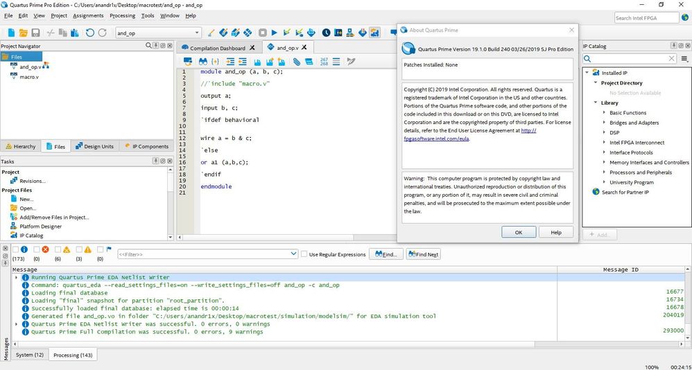

    Hi Luis,
    1. We need to add the include (macro)files to the project and just compile for Quartus STD & LITE.
    2. For Quartus Pro, the compiler to search for macro file and include it during the compile process. No need to use `include in Verilog module. Please check the attached image
    We recommend user to just add the `include "define.v" statement to the start of your design file and add macro file in file list.
    Hope it helps! Let me know if you need any further assistance.

    • AnandRaj_S_Intel's avatar
      AnandRaj_S_Intel
      Yes, We can use by including the macro files into the file list. If we don't include macro files in file list than we have to `include <file> in each Verilog module.
      Please check the attached image.
