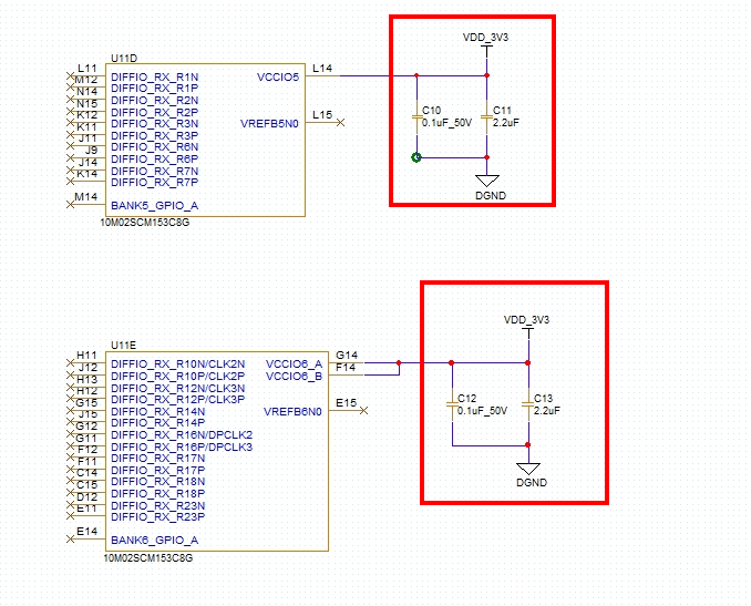

Hi, can anyone assist me? Because my board is too small, I have to reduce many passive components.
- MartinMaa
I am not using these I/O pins. Can I remove these resistors and capacitors to make VCCIO non-connected.

Based on this Knowledge Article Is it necessary to power all the VCCIO IO Banks on a MAX 10 device... (intel.com), it is recommended to power-up all the VCCIO rails even when not used.
However, you may choose to connect to the power rails to minimum required power mentioned in the datasheet, like 1.0V. Single Supply Devices Power Supplies Recommended Operating Conditions (intel.com)
