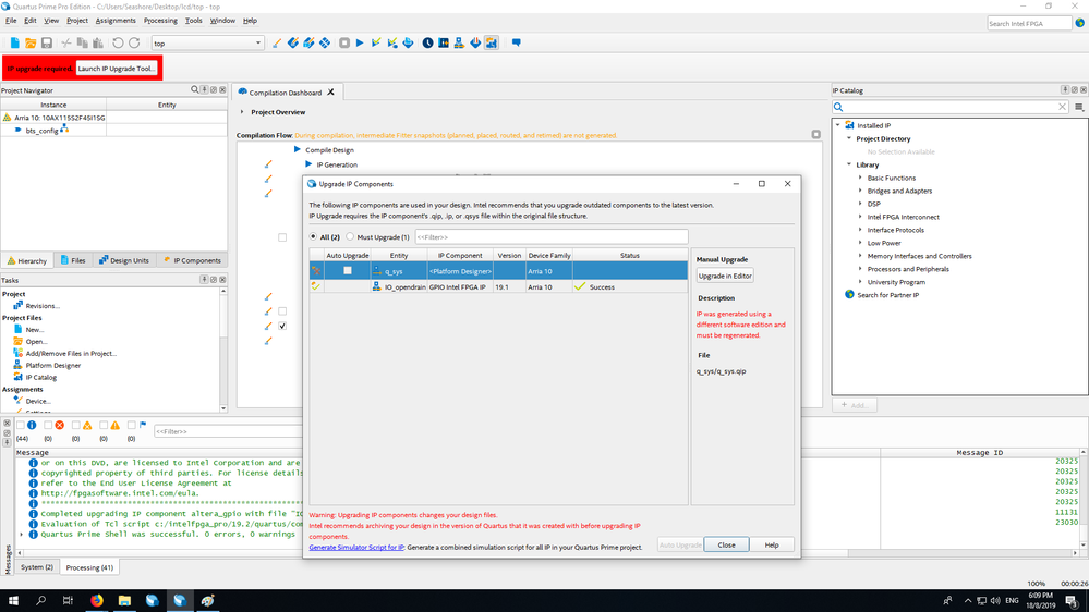

i have arria 10 gx development board from altera. i tried to use lcd example code from altera https://fpgacloud.intel.com/devstore/platform/16.1.0/Standard/arria-10-gx-lcd-display-reference-design/ but there are some error
i am using quartus 19.2
i am not able to update q_sys
and there is also some error reguarding 12c opencore

    There will be some problem if you update your IP jumping the version too far from Q16.1 to Q19.2. What you can do is reinstantiate the IP manually. The setting should be in the .ip files

      how can i manually install. i tried using upgrade in editor

    What I mean is create this new IP in the IP catalog. And slowly put in the setting value base on the *.qip.
