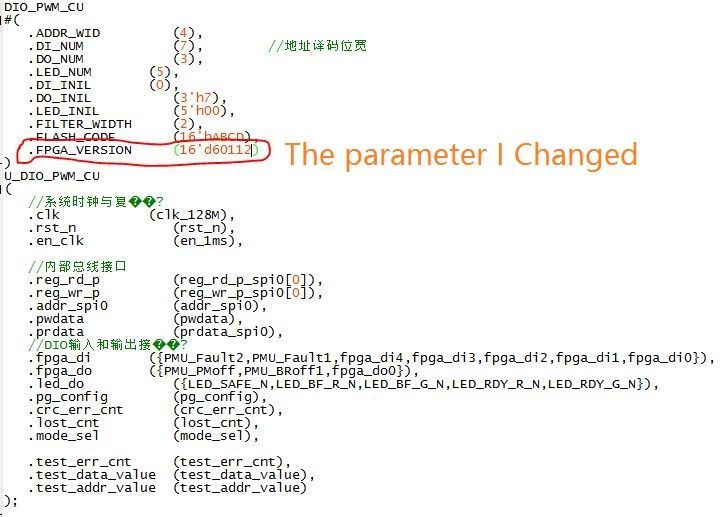

There are about two modules in my project,a module of serial communication and a parallel data bus interface to my DSP.

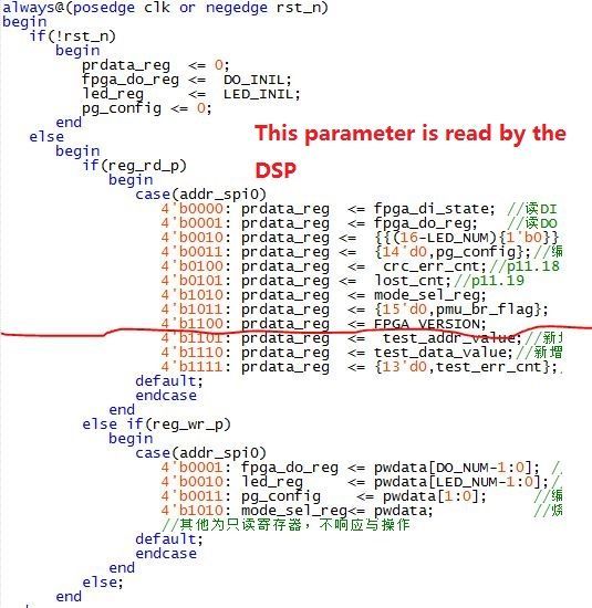

When I changed the parameter "FPGA_VERSION" from "16'd60112" to "16'd112",then another module in my project did't work well,by the way ther are no busyness between the two modules,as well as I change it back ,then all is well.But if I use the standard version of Quartus,the same problem won't happen.
- sstrell
Without knowing what affect the parameter has on the other module, there's no way to really figure out what's going on here. The only thing I can think of is that 60112 requires all 16 bits (0xEAD0) while 112 only requires 8 bits (really only 7 bits; 0x70). So perhaps some type of optimization for this is different between Lite and Standard, though I doubt it. More info is needed. What is not working well with the changed parameter value?

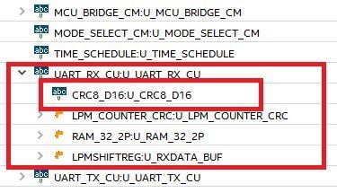

There is a CRC check in my serial communication receive module ,the CRC will be always wrong when I change the parameters "FPGA_VERSION".And I make sure there are not any connections between the two modules.
- sstrell
So perhaps the upper 8 bits are getting optimized away and that affects the operation of the CRC? Not sure without seeing the code.
