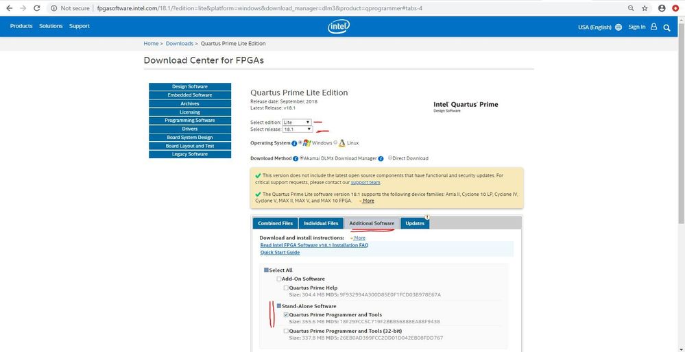

    4. After this, if issue still persists then provide these all details like Quartus Edition(lite/pro/std), Kit/board & importantly screenshot of device manager.
    5. If possible perform same experiment on different machine(Windows 10) with stand alone Quartus programmer( download it from below link, as shown in screenshot as per your requirement)
    http://fpgasoftware.intel.com/18.1/?edition=lite&platform=windows&download_manager=dlm3&product=qprogrammer#tabs-4
