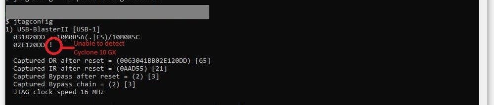

I cannot detect the jtag of my arria 10 fpga via blaster.
I cannot detect the jtag of my arria 10 fpga via blaster. I guess it is related to my wrong action of jtag chain debugger but I do not remember the detail action. Attach the detection result.

If you see the similar issue ! warning as above [open Nios II prompt Command, and execute command "jtagconfig".], it probably the windows issue.
Solution:
Open Quartus / Quartus Programmer as Run as Administrator. This should help you to detect the device.
