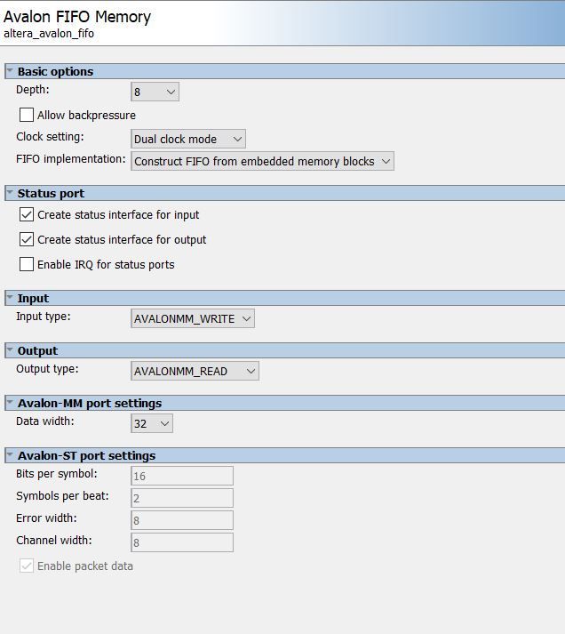

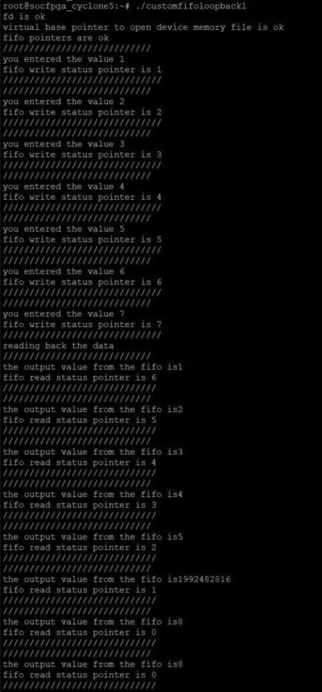

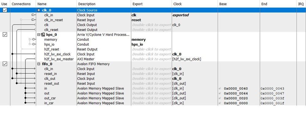

​Hi, I have following questions?
  1. Why read pointer is 1 less than the write pointer?
  2. What is this dump value 19844532 at position 0 of read status pointer?
  3. I am writing 1 to 8 to fifo but not getting the last digits as fifo read status pointer reaches 0.
Here is my code and designs.

	printf("////////////////////////////\n");
	printf("you entered the value %d\n",*FIFO_write_ptr);
	printf("fifo write status pointer is %d\n",*FIFO_write_status_ptr);
	printf("//////////////////////////////\n");
printf("reading back the data\n");
for(i=0;i<8;i++)
	//reading data from the fifo
	printf("the output value from the fifo is%d\n",*FIFO_read_ptr);
	printf("fifo read status pointer is %d\n",*FIFO_read_status_ptr);
	printf("/////////////////////////////\n");

  • Hi,
    May I know which Quartus Version you are using and are you using Cyclone V soc?
