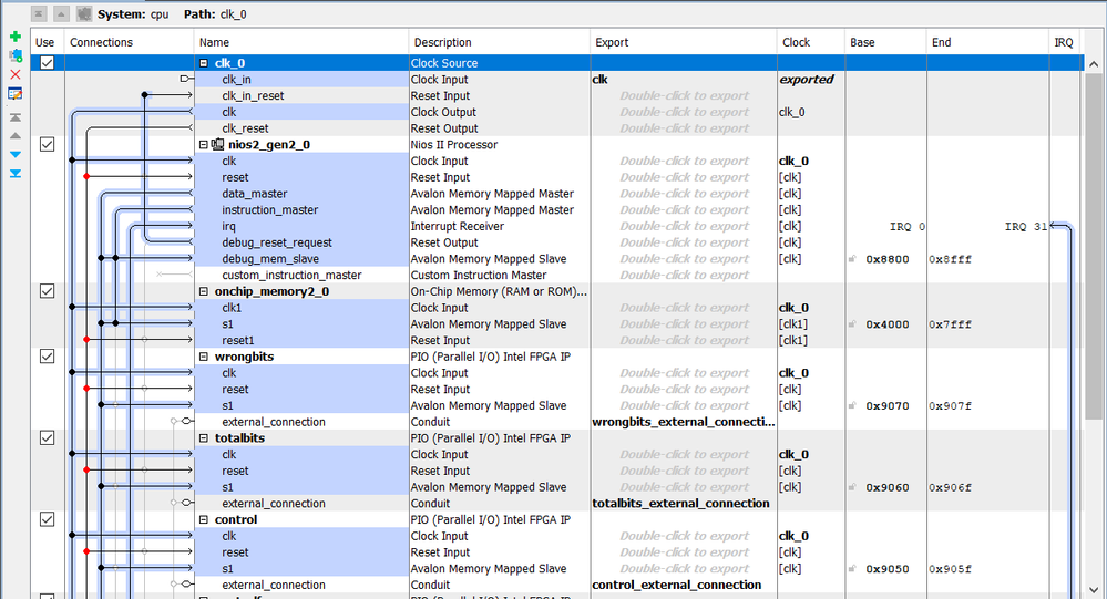

I wanted to communicate data over serial port. At first I used the Jtag Uart Intel Fpga module. In this part I was able to see the incoming data in the Nios II console.

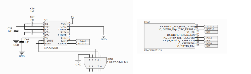

Then I wanted to communicate the same data using the rs232 module and a custom board (find the schematic below) in which a max232 is the interface without succeess.

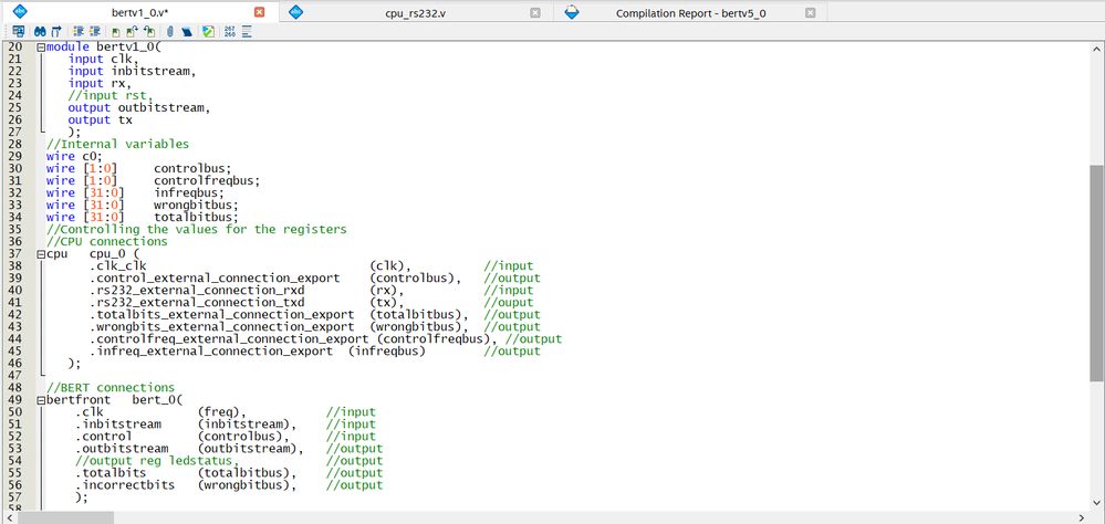

I was wondering what can be wrong but I don't know where is my mistake. I have taken a look to the configurations in the Qsys as well as the Nios II code.
Could someone here please tell me what I'm doing wrong?
Thanks in advance. Below you can find my configurations and the Nios II code.
1 Reply
- a_x_h_75
Contributor
I don't see a standard UART in your QSYS system. Do you have an RS232 UART (search the IP catalogue) connected to your processor?
