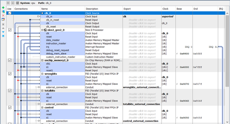

6 years agoHow to run the Nios II Hello world small example using the rs232 module in combintation with max232?

6 years agoI don't see a standard UART in your QSYS system. Do you have an RS232 UART (search the IP catalogue) connected to your processor?
Cheers,
Alex
