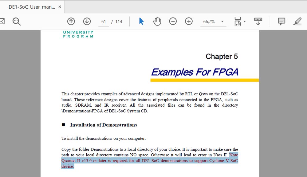

May I know do you using the terasic board: DE1-SOC as I found the information from the .log file.
It seems like that board BSP is not compatible with Quartus v19.1.
Could you try to check the instructions provided by terasic to see the version of Quartus used that is compatible with your BSP.
