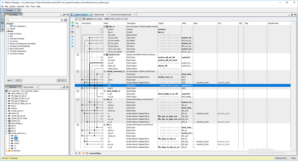

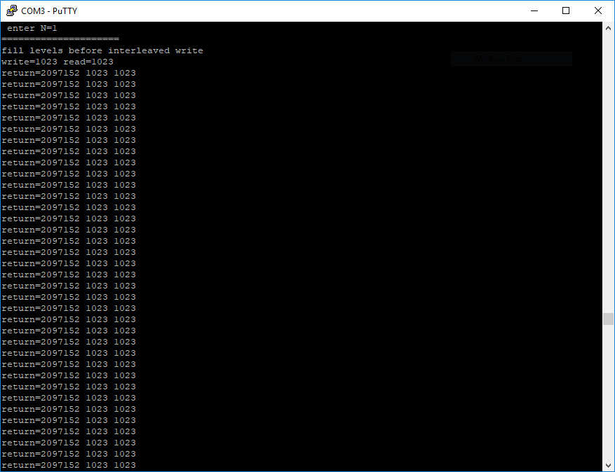

I'm currently designing a fifo interface between the HPS and the FPGA of the DE1-SoC. All the programming is done but I'm constantly getting the value 2097152 back in my HPS with the status of the fill levels 1023.
I followed the tutorial on https://hackaday.io/project/21604-fifo-interface-between-arm-and-fpga-on-de1-soc. I've added some code and screenshots with the results.
