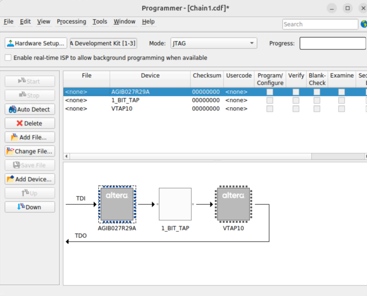

      2) Quartus 26.1 Programmer detects the following part number upon JTAG scan:
      3) In Quartus Pro 23.3 the exact part number does exist as shown in the original post 2nd picture.
      4) In Quartus 23.3 Programmer the JTAG scan shows numerous possible Agilex 7 devices which share the same IDCODE as it read during scan operation (none of them is the exact part).
