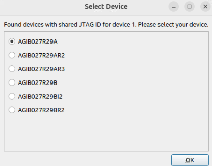

Thanks for replying, let me clarify.1) In Quartus Pro 26.1 the exact device OPN that I have doesn't exist in the device selection list:
2) Quartus 26.1 Programmer detects the following part number upon JTAG scan:
3) In Quartus Pro 23.3 the exact part number does exist as shown in the original post 2nd picture.
4) In Quartus 23.3 Programmer the JTAG scan shows numerous possible Agilex 7 devices which share the same IDCODE as it read during scan operation (none of them is the exact part).
Also, I have read the Agilex 7 known issues covered in document 683584 and see many disturbing issues that could affect my project's scope (mainly around F-tile bugs) which should be solved in newer Quartus versions so I think our focus should be on enabling the work with this specifiv Evaluation Kit with Quartus Pro 26.1

Fakhrul- Michael12 months ago
Hi Fakhrul,
First of all as I said, I can't figure out how to program the device in 23.3, please see the first screenshot of the Programmer, the AGIB027R29A1E2VR3 part number doesn't exist there, when choosing for example the AGIB027R29AR3 from the list and trying to program it, the programmer shows an error of mismatch between OPN in quartus and OPN in quartus programmer:
Also, as I said, Agilex 7 known issues document has a lot of issues that affect me and the solution there is to move to newer Quartus versions (25.1.1 and above)
