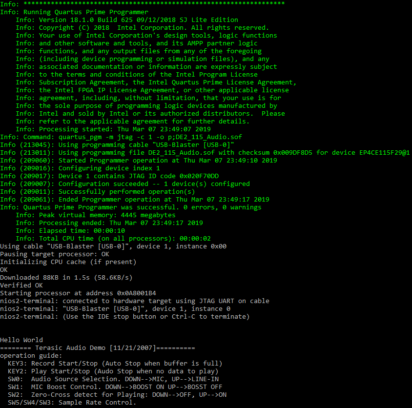

I had the same problem.
I solved it like this:
- Opened the QPF in Intel/Quartus Prime.
- Attempted to auto upgrade the IP. It failed, but it advised me to manually do the upgrade in Platform Designer. That worked.
- Compiled it.
- Downloaded it.
There is also a bug in the batch file. You need to replace the double backslashes \\ with single backslashes \ and you might need to change bin to bin64:
@ REM ###################################### @ REM # Variable to ignore <CR> in DOS @ REM # line endings @ set SHELLOPTS=igncr @ REM ###################################### @ REM # Variable to ignore mixed paths @ REM # i.e. G:/$SOPC_KIT_NIOS2/bin @ set CYGWIN=nodosfilewarning @%QUARTUS_ROOTDIR%\bin64\quartus_pgm.exe -m jtag -c 1 -o "p;DE2_115_Audio.sof" @ set SOPC_BUILDER_PATH=%SOPC_KIT_NIOS2%+%SOPC_BUILDER_PATH% @ "%QUARTUS_ROOTDIR%\bin64\cygwin\bin\bash.exe" --rcfile ".\DE2_115_Audio_bashrc" pause
