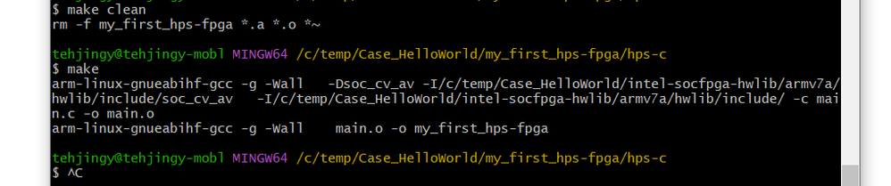

    I see that you are running the compilation in a windows environment.
    Did you run it in the msys2 ? (https://www.msys2.org/)
    https://www.rocketboards.org/foswiki/Documentation/HWLib#Windows_Installation
    I managed to run it without the error you are seeing
    Could you try the binary compiled using the arm-linux-gnueabihf as suggested from the how-to attached.
    I downloaded the compiler with the link below:
    https://releases.linaro.org/components/toolchain/binaries/latest-5/arm-linux-gnueabihf/
    and exported the following env var.
    export PATH=`pwd`/gcc-linaro-5.5.0-2017.10-i686-mingw32_arm-linux-gnueabihf/bin:$PATH
    export CROSS_COMPILE=arm-linux-gnueabihf-
