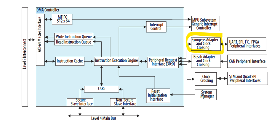

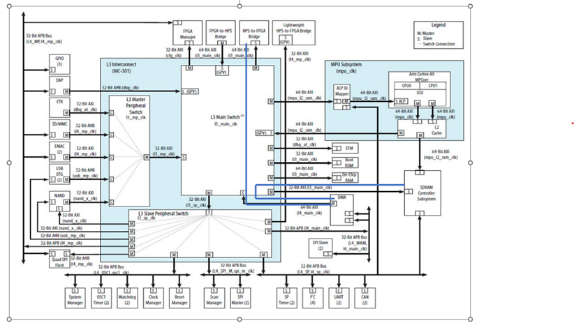

I want to transfer data from the FPGA to the cyclone V's SDRAM, using the hardware DMA as illustrated in the following figure
I configured the DMA by the HPS. To handle data transfer, the DMA is equipped with a " peripheral request interface", this interface is connected to the block " Synopsys adapter and clock crossing".
The only information available from the document 'Cyclone V hard processor system technical reference manual' is that this block is controlled by the fpga using the following hand shake signals:
- dma_tx_req_n
- dma_rx_req_n
- dma_tx_ack_n
- dma_rx_ack_n
- dma_tx_single_n
- dma_rx_single_n
Is it possible to have technical support on how to control those signals in order to inform the DMA that there is data available on the FPGA side?
