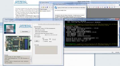

But when I opened the BTS the result was pretty bad (see below):
http://www.alteraforum.com/forum/attachment.php?attachmentid=11727&stc=1 "NO USB BLASTER DETECTED" !
Do you know why?
NB: I made the same test with Quartus15.1 standard edition, with Quartus13.0 and with the Quartus13.0sp1 (and in all cases did not work)
Thanks for any comments, remarks or ideas to fix this problem.
