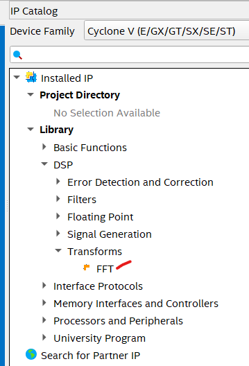

      Hi, sorry for the late reply.
      Is the IP you mentioned an FFT IP? If so then I can find it in the IP Catalog.
      If not, could you tell me which IP is needed? And which Library does it belong to?
      Thank you.
  • SyafieqS's avatar
    SyafieqS
    Yes it is the FFT as in the picture. You need license for that.
