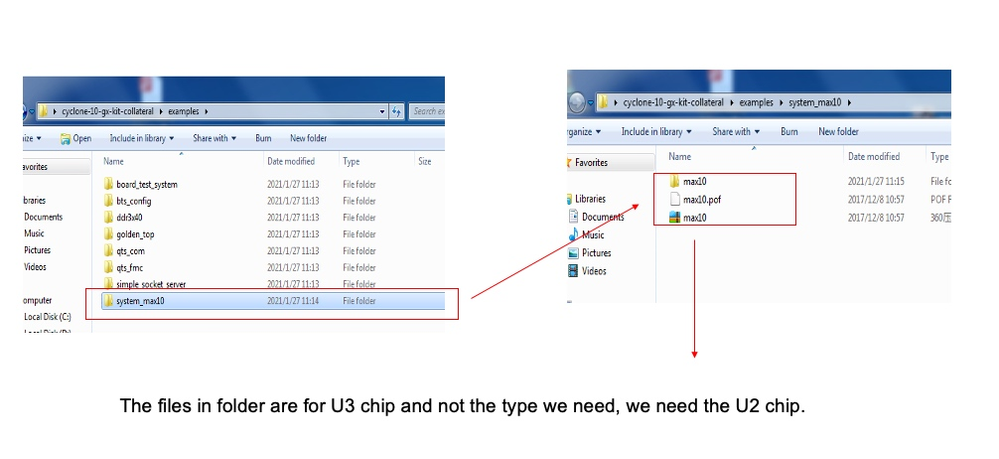

I got in to the link you provided, but the files are not the one I need, This files is for U3 chip(CFG MAX10), I need the files for U2 chip (SYS MAX10).
Could you please help to check again and provide the new link to me?

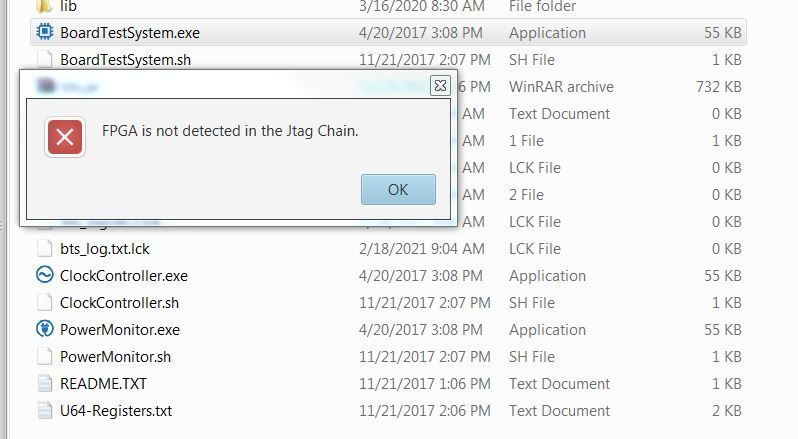

Thank AabdRahman! I am testing a new kit DK-DEV-10CX220-A but when I use BoardTestSystem. It can not start with the error "FPGA is not detected in the Jtag Chain"
