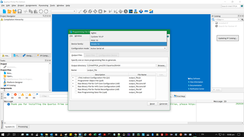

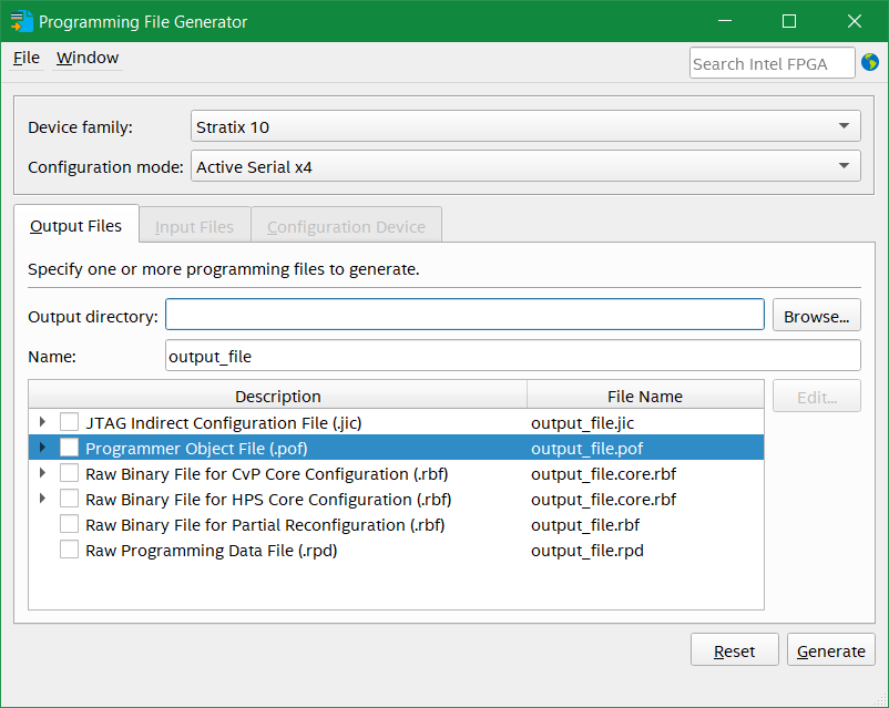

Arria 10 Programming File Generator
Is there POF or JIC file generator for Arria 10?
I'm using Quartus 20.1 and the device family drop down list doesn't contain Arria 10 option.

Please use "convert programming file" to convert instead of this. This is meant for some dedicated devices only.

I only installed this particular 20.1 version and it has all "10" families except ARRIA. Older "5" families are not available as well, but it's not a problem for my file conversion. My Arria SOF is working fine on my Arria FPGA. I would just need to have a utility to convert my Arria SOF to Arria POF or JIC.
From the download center, searching by any device family will pop up the same ID 660925 regardless Arria, Stratix, Cyclone etc.
Then why would the generator tool shows all other families bundled into 1 version but exclude Arria?
I did not notice any difference in selecting any of the family. Can you advise how to select a version that can convert Arria SOF to Arria POF or JIC?
- RyanT
Thanks, @sstrell and @YuanLi_S_Intel .
I used the "File -> Convert Programming Files" option and can now convert to POF and JIC.
