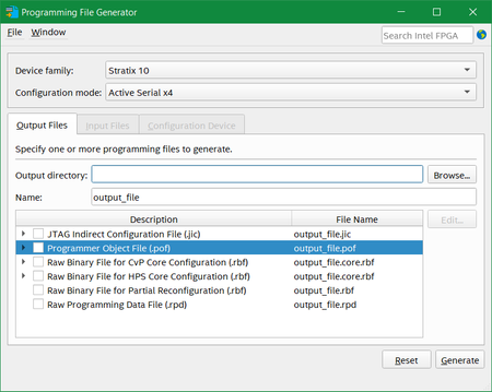

Is there POF or JIC file generator for Arria 10?
I'm using Quartus 20.1 and the device family drop down list doesn't contain Arria 10 option.
- 4 years ago
I partially misread this. I saw the screenshot and thought you were trying to convert a programming file from A10 to S10. My mistake.
The "5" families are not supported in Quartus Pro.
You're looking at the wrong part of the tool. You want File -> Convert Programming Files.

4 years agoThanks, @sstrell and @YuanLi_S_Intel .
I used the "File -> Convert Programming Files" option and can now convert to POF and JIC.
