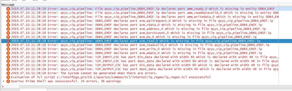

Ok, so I am punting on the Cyclone V reference design, and tried to open the UHD Video Reference Design which targets the Arria 10 GX.
I get a ton of errors when opening in the design in 19.1.
I am now trying to open Platform designer and update those to see if that will fix things. This is amazingly bad, as this is where we tell customers where to go to get started!!!!

HI Paul, If you are referring to some specific ready made reference design like Cyclone V reference design or this AN776 Arria 10 reference design then they are developed to work with certain Quartus version only. Quartus version upgraded on these designs definitely required a lot of clean up work. However, if your intention is to show case HDMI IP capability to customer then using the example design generated directly from HDMI IP will be a better choice here. You can pick any Quartus version you like and it should be error free. Thanks. Regards, dlim- PGigl

Intel is doing the improvement but only applicable for latest Gen 10 FPGA product families like Cyclone 10 GX, Arria 10 and Stratix 10.
- User can easily generate example design from the IP core directly based on whatever setting that user configured in the IP core.
- There also won't be concern with Quartus version upgrade issue as user can now generate example design from every newer Quartus version.
Unfortunately it's not easy to manage and convert legacy product design as you are aware now.
It's better to convince customer to migrate to latest FPGA product family for better support.
Thanks and appreciate your understanding on this matter.
