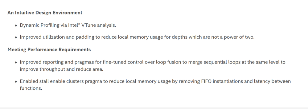

Hi, I have recently noticed that in SDK v20.1 it is that the following new feature is available:
"Enabled stall enable clusters pragma to reduce local memory usage by removing FIFO instantiations and latency between functions."
however, I could not find corresponding instructions in the manual.
Has anyone tried this new feature yet ? What pragma should I use ?
