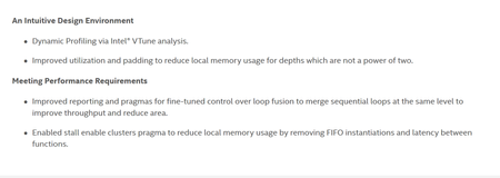

Hi, I have recently noticed that in SDK v20.1 it is that the following new feature is available: "Enabled stall enable clusters pragma to reduce local memory usage by removing FIFO instantiations an...

It seems like there is a documentation problem as there is no information for this feature. I had reported to developer to check on this problem.
You could able to apply this feature by using __attribute__((stall_enable)) to a kernel, then the compiler should only create stall-enable clusters in that kernel.
