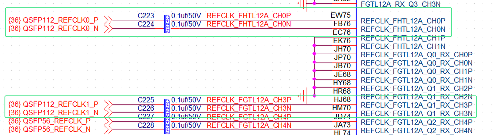

为什么F-Tile的FHT用过QSFP-112(400G光口,4*112Gbps)接口的时候需要两路参考时钟?其中一路参考时钟输入给REFCLK_FHTL12A,一路是需要输入给REFCLK_FGTL12A吗?
如下图所示的设计连接是否可行?
- Farabi_Altera
English translation:
Why does F-Tile's FHT need two reference clocks when it uses QSFP-112 (400G optical port, 4*112Gbps) interface? One of the reference clocks is input to REFCLK_FHTL12A. Does the other one need to be input to REFCLK_FGTL12A?
Is the design connection shown in the picture below feasible?
- Farabi_Altera
Please refer to pin connection guideline : https://www.intel.com/content/www/us/en/docs/programmable/683112/current/f-tile-transceiver-pins.html
regards,
Farabi
