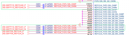

为什么F-Tile的FHT用过QSFP-112(400G光口,4*112Gbps)接口的时候需要两路参考时钟?其中一路参考时钟输入给REFCLK_FHTL12A,一路是需要输入给REFCLK_FGTL12A吗? 如下图所示的设计连接是否可行?

1 year agoPlease refer to pin connection guideline : https://www.intel.com/content/www/us/en/docs/programmable/683112/current/f-tile-transceiver-pins.html
regards,
