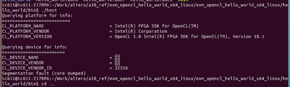

I am currently using an a10 reference board, and I have recently upgraded to v18.1.0. I recompiled the official helloword example, and found out the host program crashed like follows,

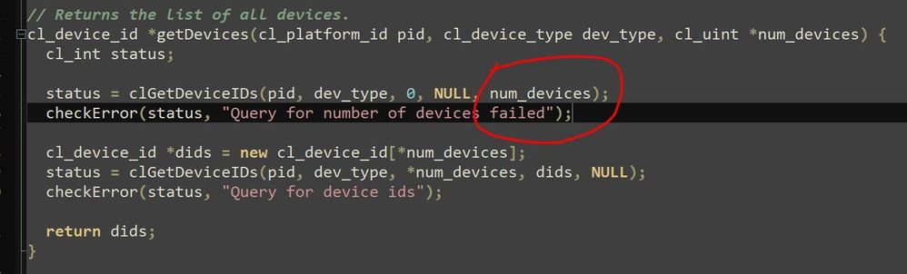

So, I digged into the file ./common/src/AOCLUtils/opencl.cpp, and printed out the value of variable num_devices for the clGetDeviceIDs function, and it always show a value of "33".

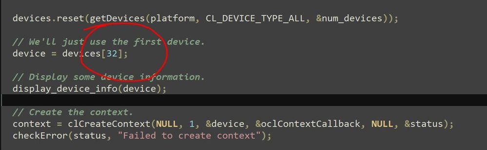

Therefore, in the host program of the example, I changed the device num to 32 as follow

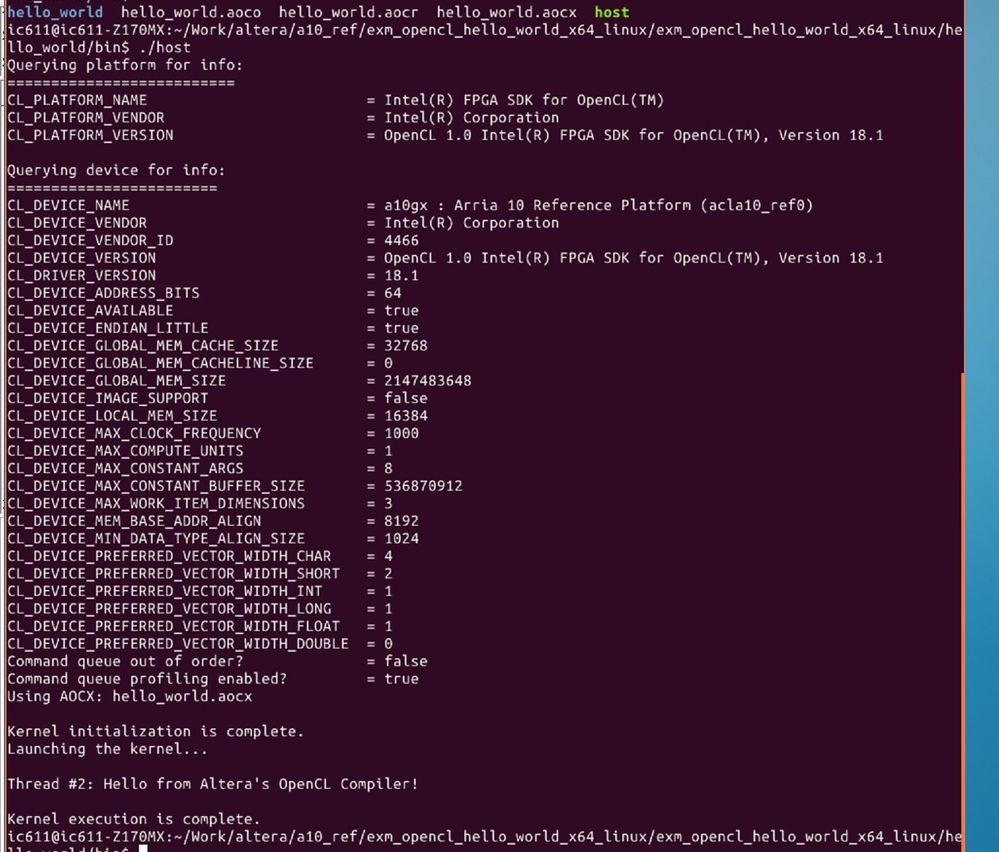

This time, it works correctly:

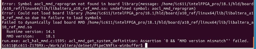

How could I keep the runtime enviorment for both boards on the same machine. When I run the application for de5-net, the following error shows up:
It seems that the runtime is loading the lib file from the a10_ref BSP folder, however, I have set the AOCL_BOARD_PACEKAGE_ROOT varaible to de5-net 's BPS folder.
- HRZ
Check you ~/.profile; recently the installer of Quartus adds its environmental variables directly to that file which might conflict with your configuration in ~/.bashrc.
