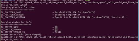

7 years agoPossible bug in FPGA OpenCL runtime for v18.1.0 (verified with a10_ref)
I am currently using an a10 reference board, and I have recently upgraded to v18.1.0. I recompiled the official helloword example, and found out the host program crashed like follows, So, I di...
