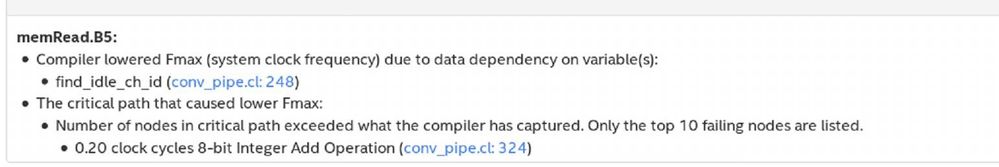

I was compiling the same kernel code by using both v18.1 std and pro. For the standard version, I could achieve a fmax around 220 MHz, but for pro version, the fmax is only 190 MHz.

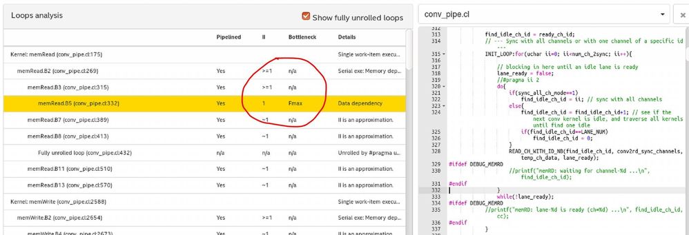

I further compared the report.html, and I found that loop dependence is found in the pro version report, but in the standard version everything is OK.

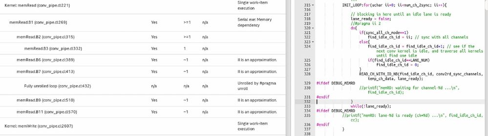

      For 18.1 std, the following code are succefully pipelined with II=1, with no warning:
      But for 18.1 Pro, a fmax warning is shown in report.html as can be seen here:
      dependency is found on variable find_idle_ch_id here:
      For this reason, a fmax=190MHz is generated for a10 device, while for s5 device the fmax is 220MHz.

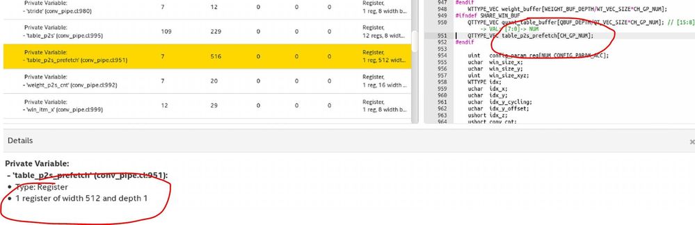

      Another odd thing is that sometimes 18.1 Pro generates unreasonable registers for private variables as follow:
      The variable table_p2s_prefechtor is actually 16-bit width (unsigned short), but the compiler make it 512-bit wide, this makes feedback logics in-efficient.

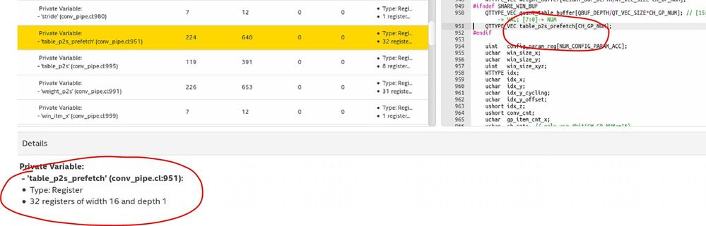

      For 18.1 std version, there is no problem:
