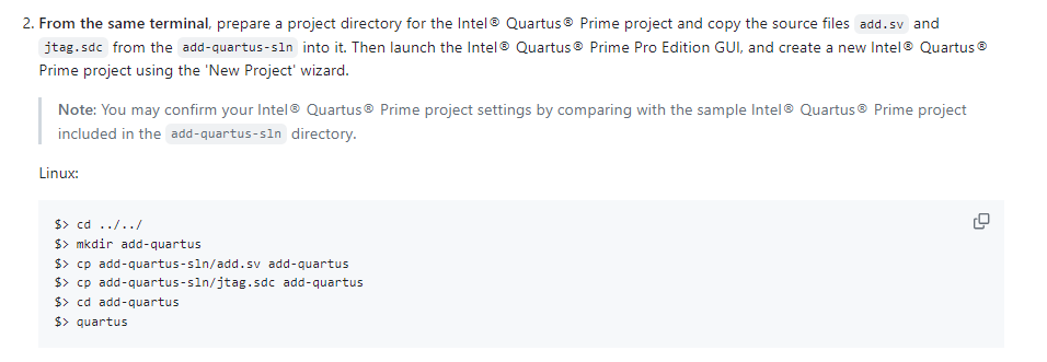

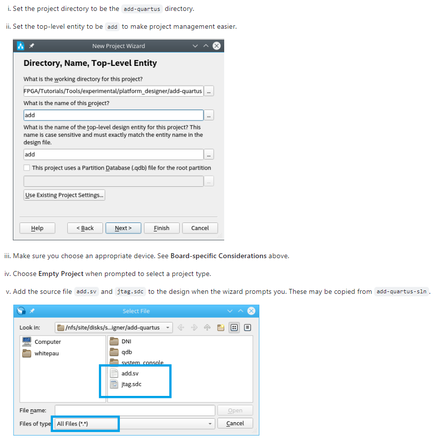

something is unclear to me, you create a project in Quartus but it seems you do not create a Top-level entity, since when I do "Start Analysis and Elaboration" I get an error about that, I wonder if a top-level entity should be created anyway and what should look like. In one screenshot from the previous github I see that the top level entity is named "add" when you create the project, but then nothing is mentioned about it (what should just contain?)
Thanks @yuguen for clarifying the content of add.sv
However I had followed the instructions and after I issue "make report" the following files are generated (there is no add.sv but rather add_report_di.sv which internally has a different module name and subsequently Quartus complains about missing top node. Why do I get add_report_di.sv rather than add.sv?

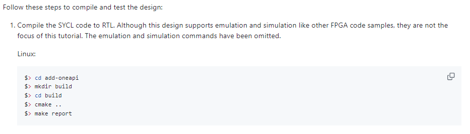

When doing "make report", you are generating RTL for the SYCL code that is in the add-oneapi folder.
This RTL top module can indeed be found in "add_report_di.sv".
This is the IP that you need to integrate into an existing RTL pipeline.
The "add_quartus_sln" folder already contains RTL, and is there to mimic your own RTL pipeline. So the "add.sv" file is already there, before you do "make report" as this is not a generated file, this is the existing RTL pipeline. You can peak into this file and see it is making a led turn on on the FPGA based on another signal. This is not possible to express using SYCL.
This tutorial shows how to connect the generated RTL from SYCL (the add_report_di.sv IP) with the existing "add.sv" RTL pipeline.
So "add" from add.sv is the top level module, that depends on the SYCL generated RTL.

1/ generate the SYCL IP
Create a Quartus project with the existing RTL files:
This also sets the top level module to "add" which is contained in the add.sv that was just copied from add-quartus-sln

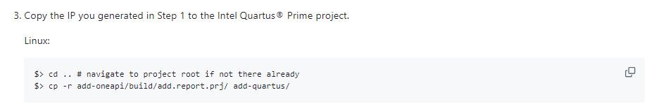

Then, import the SYCL generated IP:
Then connects the two in the following steps, etc.
