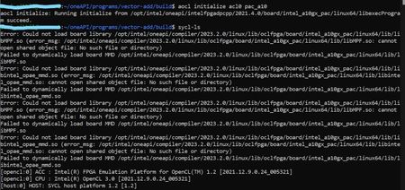

I had previously installed oneapi version 2023.2.0, however due to compatibility issues with my ubuntu version, I downgraded to oneapi version 2021.4.0. I successfully initialized my fpga board but i...

Based on the screenshot, there seems to be an output from the command sycl-ls.
Perhaps you can also check run the aocl diagnose command to check on the initialization.
As for the error mention it seems to be related to version 2023.2.0.
Hence would suggest to check if the version 2023.2.0 are completely uninstall
