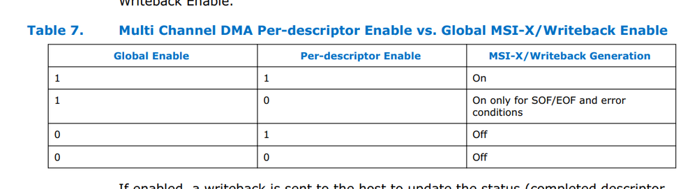

5 years agoNot getting MSI interrupt for H2D flow in intel's mcdma for pci express
Hi ,
I'm using intel's Multi Channel DMA for PCI Express . In the user guide it says we have a global MSI-X enable but i'm not able to find it. How to program this global bit as 1.
Thanks and REgards
heeral
HI,
I believe the global bit is referring to bit[9:8] in table 13 Q_CTRL (Offset 8’h0) (page 19)
dlim
- Deshi_Intel
HI,
dlim
- heeralk
Hi ,
Thanks for the reply , i'm able to get the msi interrupt now.
Heeral
