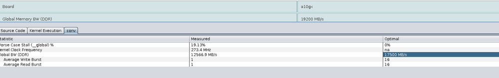

I am looking at my report generated by compiling my opencl kernel for intel fpga . So in that report I am see average write burst and read burst measured as 1 but optimal possible is 16. I believe having more read burst will help improving the design but not sure how to do it. Any suggestions will be really helpful

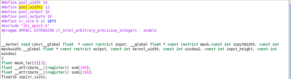

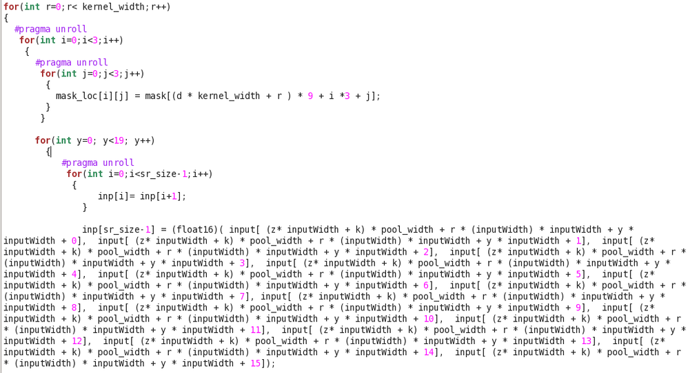

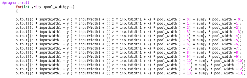

Okay , I am sharing the part where I am reading from the memory and writing to the memory. If from that you can give me some suggestions it will be helpful. I can share full code if you need though , just sharing this part as code is very lengthy

Here are my header declarations
- HRZ
Unless I am missing something here, you should get one 512-bit read port for input and one 512-bit write port for output and one 128-bit port for mask. Assuming that your board has two banks of DDR3/4 memory, this should give you relatively good memory throughput. Can you check the system viewer tab in the HTML report to make sure the compiler is correctly coalescing the accesses? You can also archive the "reports" folder and post it here and I will take a look at it.

- HRZ
The report makes it much easier to understand what is happening. Basically, your memory performance is poor because you are putting too much pressure on the memory bus. Specifically, unrolling the "y" loop over the output write is unnecessary. The addresses are not consecutive over "y" and hence, you are getting too many [wide] memory ports competing with each other over the memory bus. Furthermore, since you are using the reference board which only has one bank of DDR4 memory, your memory bandwidth is limited to only ~17 GB/s. One single 512-bit access per iteration is enough to saturate the memory bandwidth in this case. Your kernel, however, has 14 such accesses. I would recommend using a vector size of 8 instead of 16, and avoiding to unroll the "y" loop over output writes. This will result in two 256-bit accesses for input and output. I assume the mask read is done only once, so it shouldn't cause much contention on the bus.

To make sure I get low stall rate I am using float8 and float8 reading and writing. I got the improvement with respect to the stall rate , reduced to under 20% , but I am still not able to utilize optimal write burst size and read burst size of 16 . Can you suggest something on that perspective?
I have attached my report and result on profiler I am getting

What the profiler is reporting is really not that important as long as you are saturating the memory bandwidth. Calculate how much data you are moving in and out of the FPGA (to/from external memory) and divide it by the kernel run time and compare against the theoretical peak throughput of the external memory. If you are getting at least 70-80% of the memory throughput, you are at near-optimal performance.
- ADua0
I have calculated the memory throughput, it turns out I am able to utilize 50% bandwidth which is measured . for example, in my case I am achieving 12GB/s of bandwidth and measuring the throughput I get ~ 50% efficiency which in fact aligns with memory efficiency I get from the profiler. But theoretical external memory bandwidth possible is 19GB/s of which I am able to utilize only 30%. I am not sure how to improve on that factor, I have 8 read and 8 write ports so there should be minimal memory contention?
