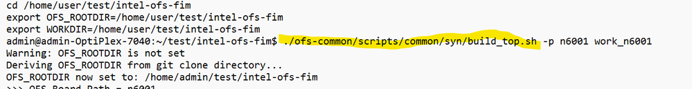

Hey @khtan,
I am done testing the N6000 card, and wanted to test the N6001 design in the N6000 card without enabling the E810 Controller. Hence I started building and compiling the N6001 design, but the script fails.
Traceback (most recent call last):
File "/usr/bin/afu_json_mgr", line 5, in <module>
from packager.tools.afu_json_mgr import main
File "/usr/lib/python3/dist-packages/packager/tools/afu_json_mgr.py", line 35, in <module>
from packager.utils.afu import AFU
File "/usr/lib/python3/dist-packages/packager/utils/afu.py", line 37, in <module>
from jsonschema import validators
ModuleNotFoundError: No module named 'jsonschema'
Error: "afu_json_mgr json-info --afu-json=/home/admin/test/intel-ofs-fim/ofs-common/scripts/common/syn/pim/dummy_afu/dummy_afu.json --verilog-hdr=../hw/afu_json_info.vh" failed
Copying build from /home/admin/test/intel-ofs-fim/work_n6001/syn/syn_top/afu_with_pim/pim_template/hw/lib/build...
Configuring Quartus build directory: afu/build
Error running /home/admin/test/intel-ofs-fim/ofs-common/scripts/common/syn/build_fim.sh
Exit code: 1
Below is the attached log file, any ideas as to what can be done are deeply appreciated.
Thank you,
Best Regards.

    I have a look into the logs and notice that you used
    1st log
    You shouldn't use the ofs-common/scripts/common/syn/build_top.sh , instead you should use the one under /syn/scripts/build_fim_top.sh -p n6001 work_n6001 instead. In certain version they renamed the build_top.sh to build_fim_top.sh to build the one in otcshare to avoid confusion because the release version uses build_top.sh
    The guide to build the fim is located here (https://github.com/otcshare/intel-ofs-docs/blob/main/n600x/dev_guides/fim_dev/ug_dev_fim_ofs_n600x_beta3.2.md#432-compiling-the-base-fim2x4x25g) .
    Could you try building this on your end? I've also setup my station here to build it , but it will take like 5-6 hours to build
