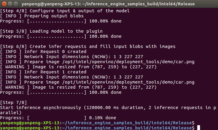

I'm testing the performance of IEI FPGA card on Openvino 2019 R1, need your help with issue as below:
When I use async mode, the prograss bar is stuck at 0.1%. but I use sync mode have not this issue.
Have you ever had a problem like this before? Can you help to take a look, thanks~
test command:
source /home/yanpeng/Downloads/fpga_support_files/setup_env.sh
export QUARTUS_ROOTDIR=/home/yanpeng/intelFPGA/18.1/quartus
export PATH=$PATH:/home/yanpeng/intelFPGA/18.1/quartus/bin
aocl program acl0 /opt/intel/openvino/bitstreams/a10_vision_design_bitstreams/2019R1_PL1_FP11_ResNet_SqueezeNet_VGG.aocx
./benchmark_app -i /opt/intel/openvino/deployment_tools/demo/car.png -m ~/work/test_hddl_openvino/models_2019_r1/fp16/squezenet1.1/squeezenet1.1.xml -d HETERO:FPGA,CPU -api async -nireq 2

    Hi, May I know if this is only happening in the benchmark_app testing only? I have tried it in my system but I am not facing any issue. Can you try with using FP16 DLA?
  • JohnT_Altera's avatar
    JohnT_Altera
    Hi. I have found the issue. The default batch size is 1. You need to change the batch size to bigger than 1 (eg. -b 10) in order for the demo to work.
