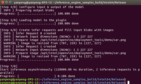

7 years agoIEI Mustang-F100-A10 run benchmark async error on Openvino 2019 R1
Product ID: IEI Mustang-F100-A10( Intel® Arria® 10 1150 GX FPGAs ) I'm testing the performance of IEI FPGA card on Openvino 2019 R1, need your help with issue as below: When I use async mode, the p...
JohnT_Altera
7 years agoHi.
I have found the issue. The default batch size is 1. You need to change the batch size to bigger than 1 (eg. -b 10) in order for the demo to work.
LHenr2
7 years agoHi JohnT,
Thanks for your reply, I'll try it on.
