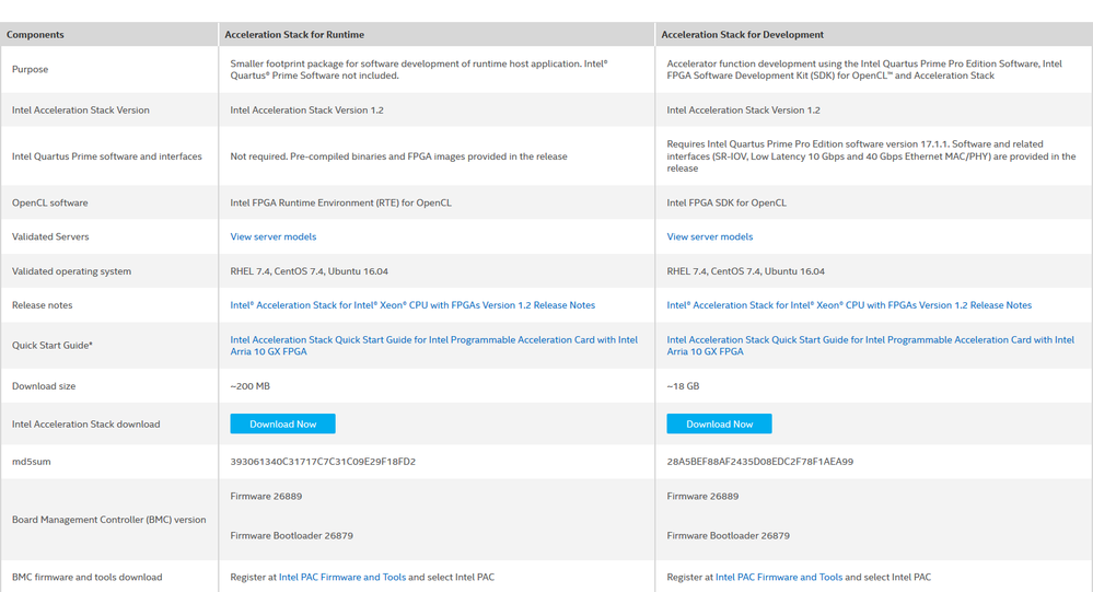

And I install dev not rte,the right one. so I don't have /opt/altera/aocl-pro-rte/aclrte-linux64

The aocx file that I used is 2019R1_RC_FP11_ResNet_SqueezeNet_VGG.aocx . I followed the step ,and I am running in root. The problem is the guide providing a runtime version. And I install the dev version in the right of the picture.

And it is a runtime version ,and I use a dev version ,and it should be sloved

But, I think it is the runtime problem. It did not solve the problem fundamentally.
because it notice me :
aoc was not found, but aocl was found. Assuming only RTE is installed.
And I have installed the DEV,not RTE .
